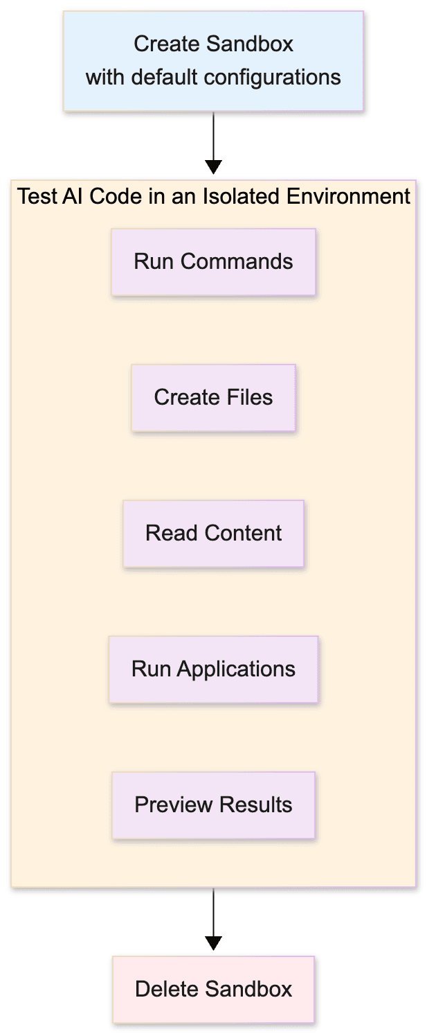

You can take several actions on your sandbox, allowing you complete control over the environment:
- File operations: Reading, writing, moving, copying, renaming, deleting files and directories. View the documentation on file operations
- Run commands: Executing commands, streaming output, managing environment variables, managing background processes. View the documentation on running commands
- Expose ports for external calls to an endpoint.View the documentation on exposing ports
Delete a sandbox
To immediately delete a sandbox, use the .delete() function:
sandbox.delete()When using sandboxes asyncronously, you can call the delete() function with await:
