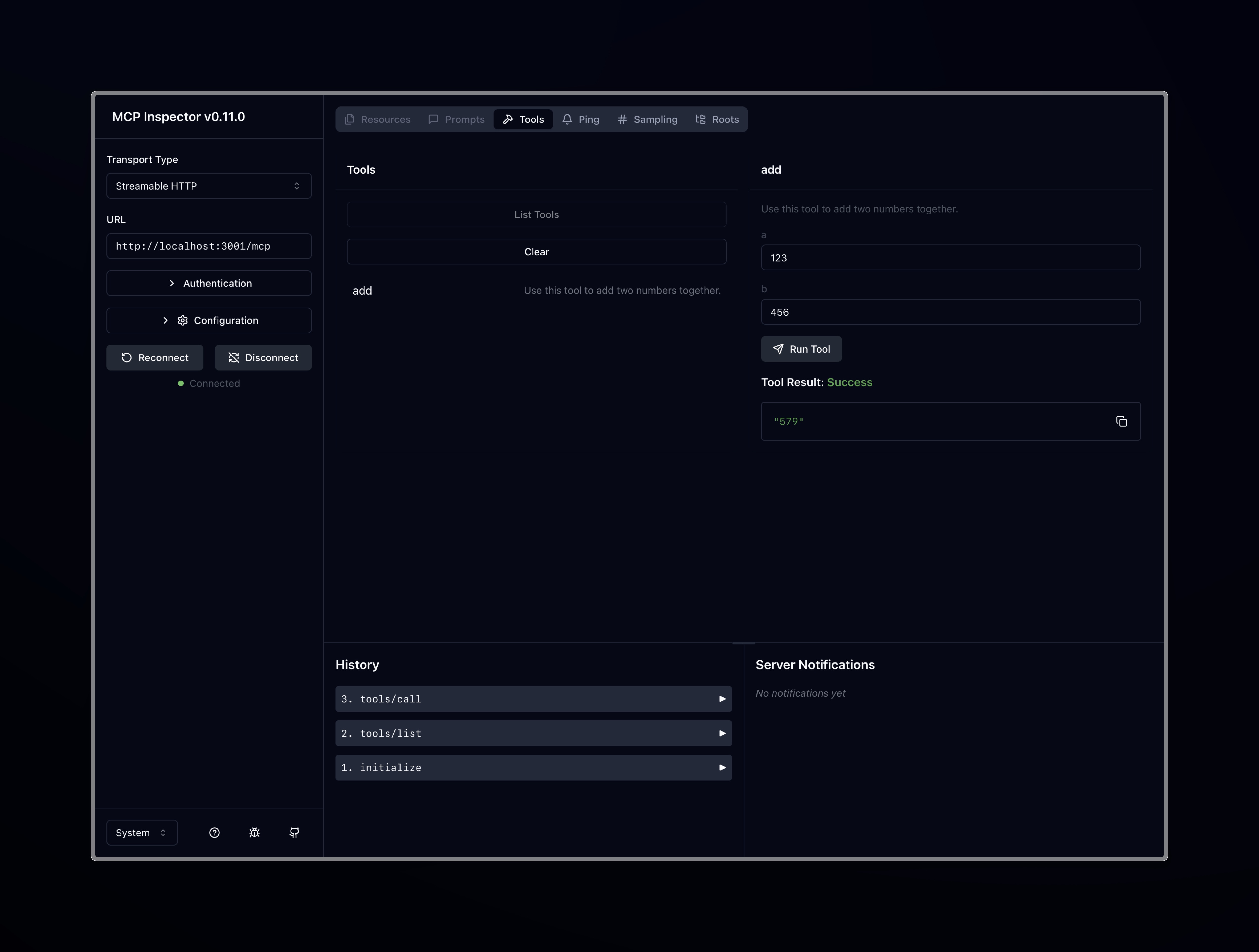

Then, launch the MCP Inspector and connect to the MCP Server:
npx @modelcontextprotocol/inspector
In your browser, go to http://localhost:6274 to open MCP Inspector.
On the page, choose the Streamable HTTP as Transport Type and ensure the URL is set to http://localhost:3000/mcp.
Click the Connect button to establish the connection.
If successful, the status should display as Connected. You can then click List Tools to see the tools available, in our case add, and call it providing the two numbers to add.
MCP Inspector test

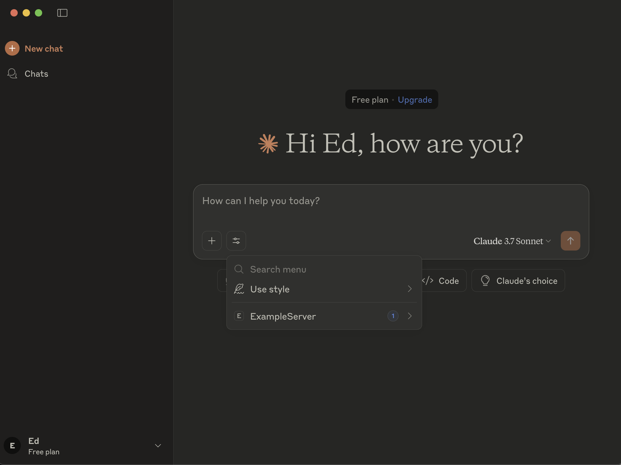

In Claude Desktop, make sure the MCP Server is properly configured and you can see the ExampleServer entry in the list of MCP servers.
Claude Desktop MCP Server configuration

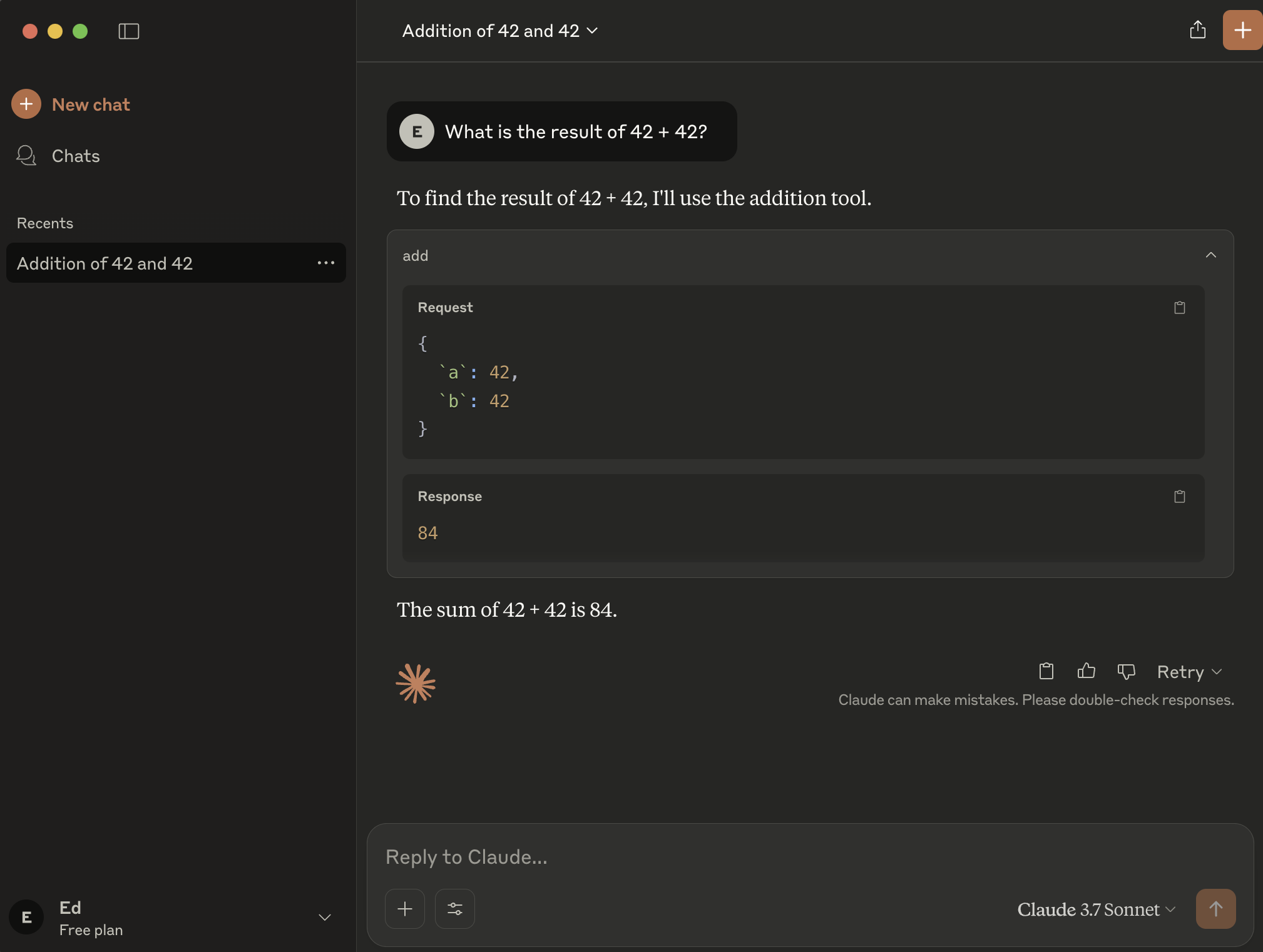

Next, let's ask a simple question that will trigger the MCP Server to call the add tool with the numbers 42 and 42:
Claude Desktop MCP Server response
As shown in the screenshot below, Claude Desktop successfully called the MCP Server, and the add tool was used to calculate the sum of 42 and 42
